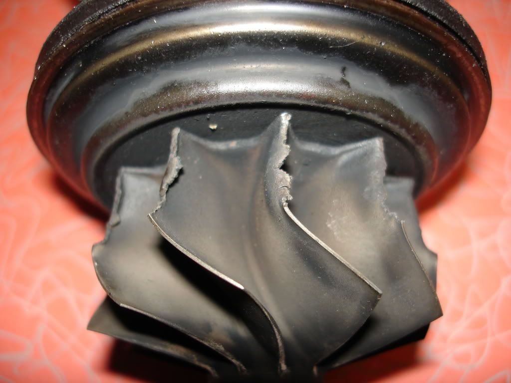

Bad news for me, turns out that the turbocharger turbine wheel is severely damaged, when the damage occured it damaged whatever keeps oil and water from entering the housing, I was told there is no seal there, but something is "sealing " it obviously, or at least WAS sealing.
The motor spit something out and the turbo ate it long story short, turns out Garrett is not on my SH!T list after all.
I have no idea what happened or when, truck has been running fine all along except for the smoke recently, also turns out my turbo is a GT3076, not a 3071 :shrug:, so I think I need to build the motor and turn up the boost.
Wierd, I ordered a 3071 but got a 3076 instead, didnt find out until I was cross referencing serial numbers, it even says GT3071 on the box.
So sorry for the false alarm guys....

Sucks man. Sucked up part of a busted valve or valve seat maybe?
Well, time to build a bullet-proof motor now. :waytogo:
Yeah, what could have hit the turbine wheel? I'm thinking anything that could have caused damage to it must have come out of the engine, but you said it was running great. Maybe a piece of carbon, but I think the way you drive would prevent carbon buildup in the first place :D. Maybe spinning it too fast?
Well, I think it was from number 4 cylinder, when I did a Head gasket about 6 months ago I saw some marks on the cylinder head and piston so something was in there for a moment. I have no idea what it could have been. The cylinder looks fine, the piston was intact and the head looked fine (other than the small marks) and tests fine for compression as well, so its a mystery to me...I dont know what it was but but did it Fvck things up, I will snap a pic of my turbine wheel so you can go OMFG :eyecrazy:..
