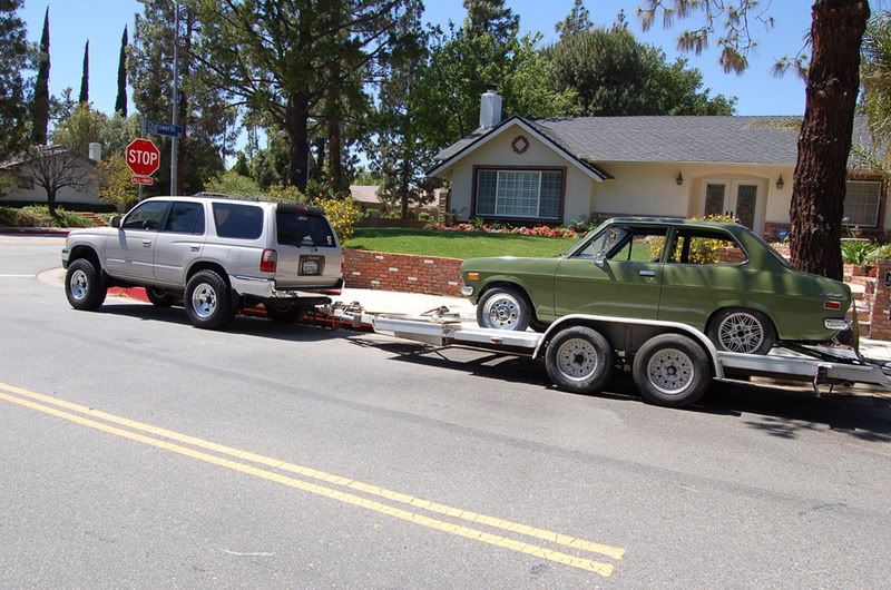

as long as you have the cooler your good... i towed all sorts of stuff with a heavy trailer plus a car...
217k on her and never opened up the motor... she was a good t4r...
