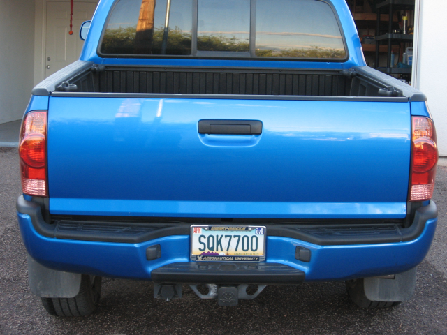

I tried the fishing line route... but it hurt the hell out of my fingers... (it was 50lb line)...
So I started using a zip tie... worked better IMHO. I would heat up the emblems with my wife's hair dryer, stick the zip tie thru the letter and just pull it all the way down the emblem... Then with some goo gone, I removed the left over adhesive... <---that part requires a little elbow grease...
For the TRD stickers on the bed, I just pulled a corner up with my fingernail and started pulling it off... that sticker rips easily so take it real slow...
that's all... cheap and easy.
