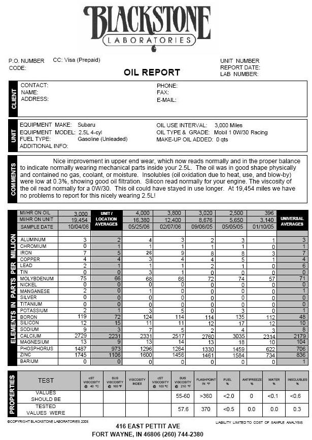

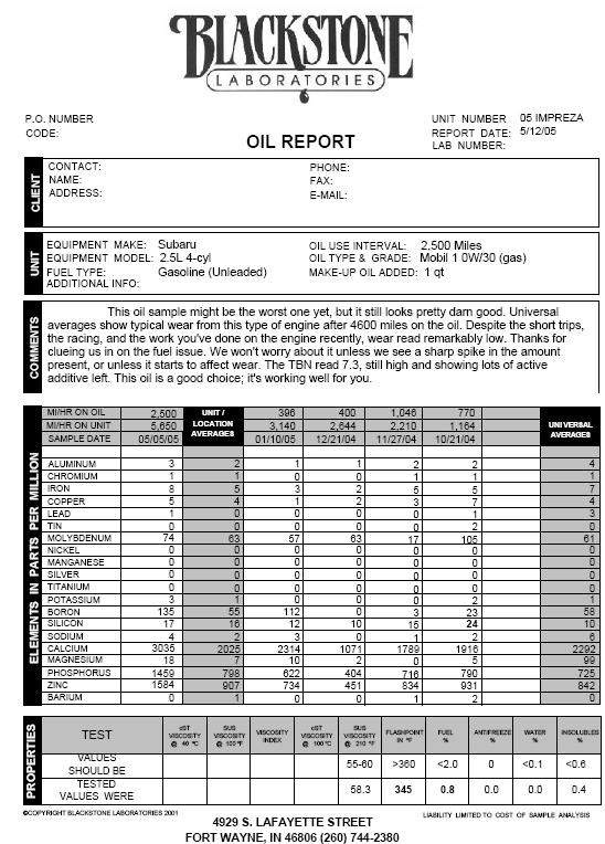

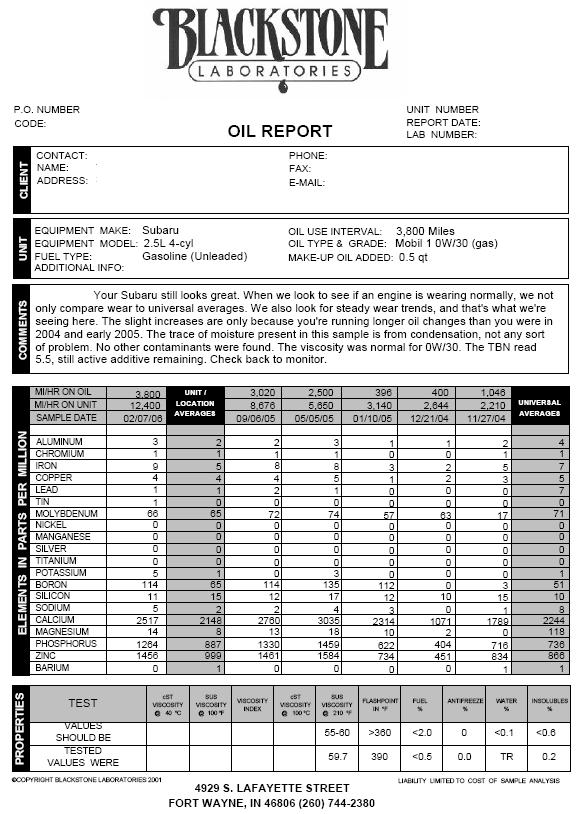

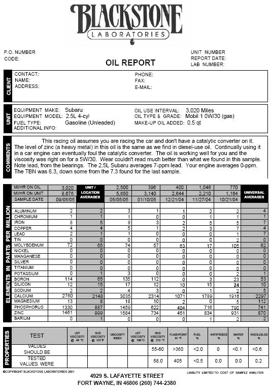

This info greatly helped me decide which oil to use in my turbo car...maybe it will benefit some of you guys as well.
What is a UOA?
Used Oil Analysis, or UOA's, tell how well your motor oil has functioned in your vehicle. By analyzing which particles of metal are in your oil, a UOA can reveal developing engine problems and provide clues into which parts of your engine are wearing.
How do I get one?
If you would like to have a UOA done on your oil, visit http://www.blackstone-labs.com and order the free test kit. Blackstone Labs charges $20 for the analysis and an extra $10 if you would like a TBN (Total Base Number), which essentially tells you how much life was left in your oil.
How do I read a UOA?
A UOA shows the elements in your oil in parts-per-million (PPM). Blackstone Labs provides this list of common elements:

In addition, Blackstone Labs provides this diagram of reading an actual report:
http://www.blackstone-labs.com/eng_balloon_report_.html
