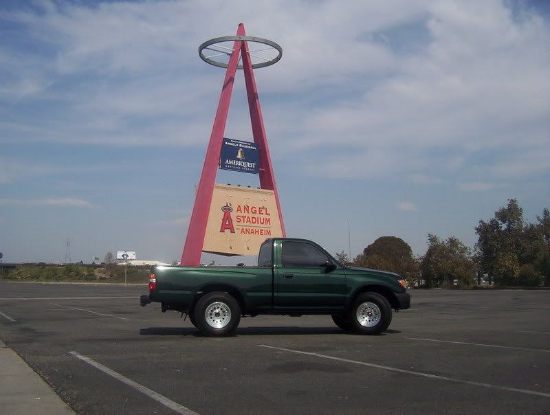

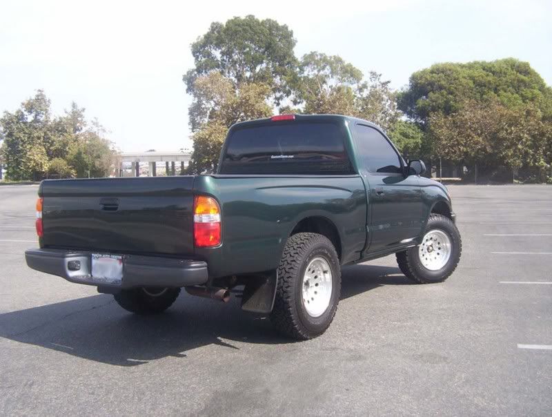

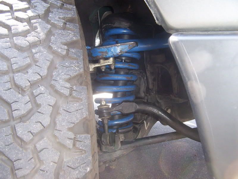

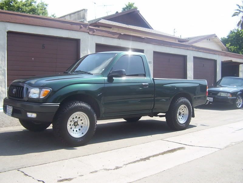

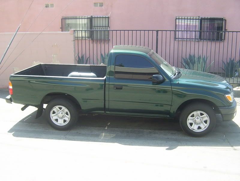

I finally got my lift and wheels on. I put the A arm and coil 3" Fabtech lift and 30x9.5 BFG A/T. It took me about...7 hrs :brickknoc I was wrenching it the whole way and had cheap autozone spring compressors and was my first lift ever installing. Overall it was easy except getting the coil compressed enough to fit on my arms. I left the stock shocks on because the idiots at 4 wheels parts gave me the wrong ones. Anyway I love how it looks and how it rides...heres a few pics!
Thanks to dx-r for the wheels, trtle for the lift and to everyone who helped me out with noob questions I had. :waytogo:
Before
After
and a couple more I took

hey kevin it is lol. i sold him yours and i installed garys 6 inch on my truck.
your truck looks good bro! all yuo need is spindles in the front and bam 6 inch. i need my windows tinted now that i see yours.
do you still have the sway bar on???

Yeah it is gonna be higher...as soon as I get more money haha I went broke making it look like that so I just have to wait a lil while longer.
Yeah the dust cap will be painted...these pics were right after the lift was done and washed.

The removal of the sway bar allows the front suspension to travel more independantly side to side; it will handle better on rough terrain. The down fall is that you will experience more body roll while cornering, but with the fabtech coils being so stiff I doubt it will make much of a difference.
If you remove the sway bar, take corners more easily until you get use to the way your truck handles without it. If you don't like the way it rides without it put it back on... it takes about ten minutes. :waytogo:
