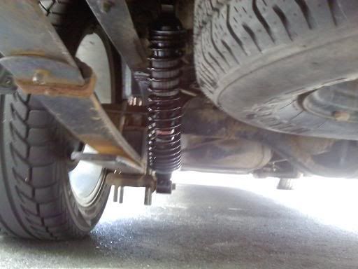

So Im not sure if anyone else has encountered this problem but with my 3/3 set up I am constantly hitting my chassis even over small bumps due to our terribly soft rear suspension, but i think i found a solution. I found some monroe load adjusting shocks that are only an inch longer both compressed and extended for a 83 toyota pickup. But they bolt right up and the best part is a set of two is 80 bucks from advance auto parts. Will be putting them on on thursday so ill let you guys know if they work.

These shocks are amazing, I just put them on and I used to rub fender and make axle/chassis contact everywhere. The rear end is so nice and stiff now it rides like my roommates 350z. no rubbing or anything, I almost dare to say i dont even need a sway bar anymore it handles so well. Be prepared however, it will raise the rear of the truck about an inch. I will post again in a few weeks to see if it settles back down. Either way it was worth every penny, for about 40 bucks a shock I cant complain. Oh and it looks sick in there...:lol:
BTW part number for those interested is
Monroe LoadAdjusting Shocks; part number 58486

There doesn't seem to be any adjust ability like with the QA-1... Essentially it's a Monroe sensatrac shock with what appears to be a progressive rate helper spring which could account for the "load adjusting" aspect the name implies... According to their website, it's good for leveling 1200# of cargo...

exactly its non adjustable, its designed to help increase payload capacity. but i can tell you my truck handles amazing wiht them on there. im about to purchase a set for the front too. part number 58263, came off of a 70-83 camaro...sound familiar qa1 guys? :evil: ill let you know how the front works out, but if it does, then that means you can basically have a cheap but great working set of "coilovers" for around 120 for all four. Good way to save up for the qa1s and wait for Brian to finish the fourlink...:waytogo:

got the fronts on today, they fit fine, but you have to notch open the holes on the bottom shock mount and put washers over the factory bolts to hold it on. works great tho, truck is hella stiff now.

still rides great, have yet to bottom out again, front softened up a little bit but the rear remains stiff. id still say the front is a great cheap alternative to qa1's until one can afford them. Part of the problem might be my front springs are shot too :(. And Ill post front pics as soon as i get under it again, I took pics but forgot to save them last time :shrug:
