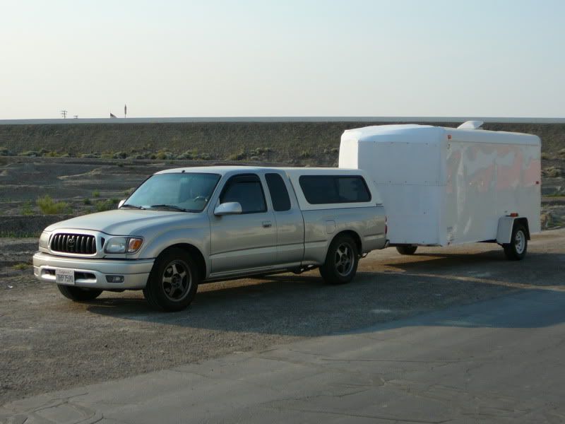

Talk to Chris D. Hes lowered and was able to haul a loaded cargo trailer from CA. to Minn.

Hey Damon..
heres the scoop..
If you don't want to change your driving style and keep the utility of your truck, a 2/3 is where you want to be..
BUT>>
Your going to have to get different wheels/tires because
the offset of those Jeep wheels are going to cause rubbing..
Or worst case a narrower lower profile tire than what you have now..
2" springs up front (Belltechs rode great with summit drop shocks)
3" steel blocks out back with a pair of air shocks are a must..
I drove cross country with a loaded bed, camper shell and hauing a trailer
that weighed more than my truck with absolutely no issues bottoming out..
I built a little fairing on the nose of the trailer to help cut through the wind..
my tires at that time were 215-65-16's..
I got such a good deal on them that I couldn't pass em up and they were a low rolling resistance rated tire..
a 3/3 would work as well, but then your goin to have to worry about rubbing
a lot more and changing your driving style if you like to swing it in corners.
