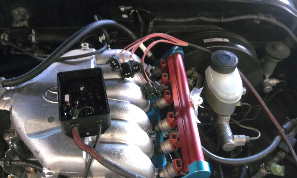

heres a couple of em
oil scavenge pump
hot side
vroom vroom
maf clamp, aic6, ftc
hot side complete
easy maf install
Was going to say, I just saw your build thread. Very Nice :waytogo: Great Job guys!!
yea unbelievable how much work there was. ran into a few issues but thats normal...sneaking the cold side to the motor was a bitch(had to bring it right by the header and theres NO room lol
Turbosmart 50mm BOV from Doug(dyotat100)
Tial wastegate from paradise
loving the sound right now, in the 4 hour car drive home(at 130 am :lol:) i listened to music for about 45 minutes...then turned it off and listened to the engine and turbo:loveeyes:)
we have a 90 degree bend as an exhaust, its loud but NO drone like my old setup, i LOVE ITTTTT!!! the BOV is sweeeeeet, i love the sound
Before anyone says anything about all the couplers/clamps.all the piping is welded, the ones up top are clamping in the plastic maf. The lower one connects the upper section to the lower section.. I love the driveability compared to my big injector, piggyback 3rz. This uses the stock maf and injectors, when you get into boost, the maf clamps, and additional fuel comes in from the port fueler and extra injectors. Its seamless when your driving it.. Methanol, more boost and tuning next weekend!
